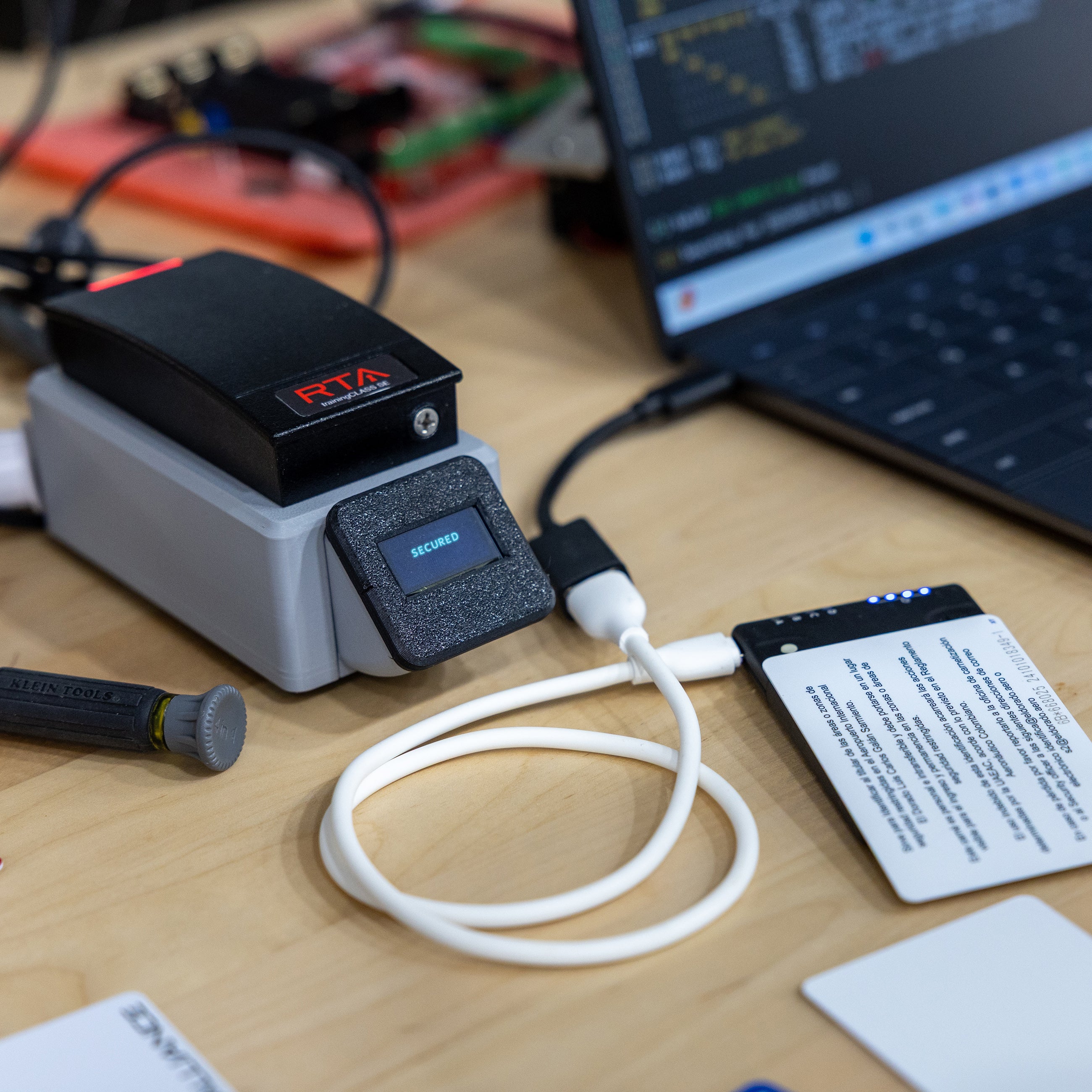

Hardware: $670 (optional) - All students in class will be issued and make use of a Proxmark3 RDV4.01 with an array of test RFID credentials and re-writable RFID credentials, an ESPkey and service tools, and our custom RFID Door Simulator and workbench analysis unit. If you wish to retain this equipment at the end of class, students may opt to pay this additional equipment fee during registration.

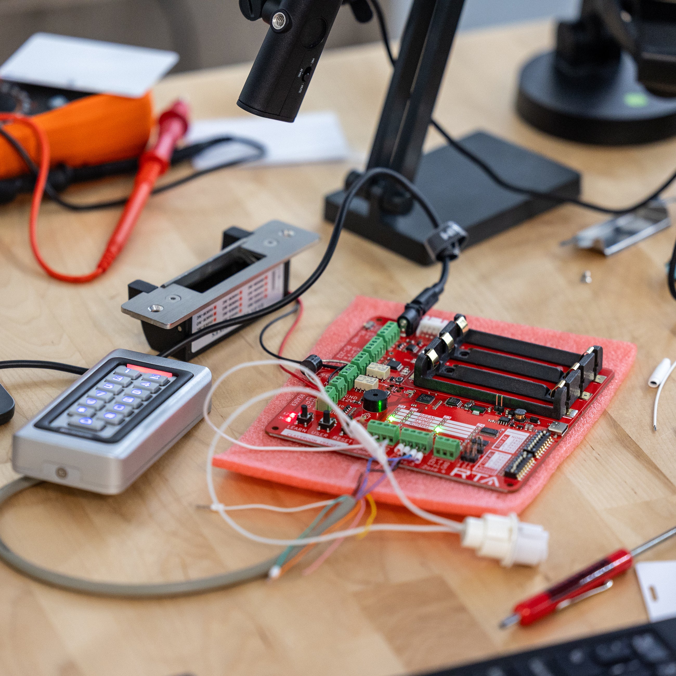

- Building and Testing Circuits on the Trainer Board
- Access Control Wiring and Component Installation

The course price includes several components used throughout both days of instruction. All items are yours to keep for continued practice after class:
- Intrusion Detection and Access Control Trainer Board
- USB-C Power Supply with USB-PD Trigger Cable
- Commercial ANSI Electric Strike
- Commercial Door Position Indicators
- Hook-Up Wire and Field Terminators
- End-of-Line Resistor Variety Pack
- Magnetic Reed Switch with Trigger Magnet
- Mini Breadboard
For an optional hardware fee ($670), students can keep a kit that provides a complete RFID testing platform for continued practice after class. Students will receive access to this equipment during Day 2 of instruction, regardless of purchase:
- Standalone RFID Reader
- RFID Door Simulator
- RFID Testing Credential Pack
- ESPKey Wiegand Field Interception Tool
A Proxmark3 RDV4 will be provided to every student for use during class. Students who wish to purchase a Proxmark3 to keep will have the opportunity to do so.
